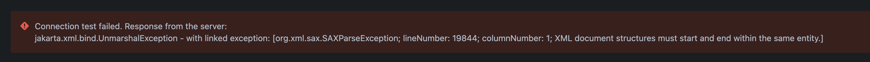

Hi,
We received this error upon crowd setup from Confluence (m-96). It’s a custom crowd directory. I just wanted to see if this error is familiar and perhaps fixed in newer versions? I wondered if this has something to do with bundled crowd version or if there is another explanation. Thanks!
Hi @EliasBrattliSorensen
The error seems to suggest the response from the directory is malformed. Have you confirmed this custom directory works with other Confluence versions? If so, could you also confirm whether the problem is still reproducible with the latest Confluence EAP?
