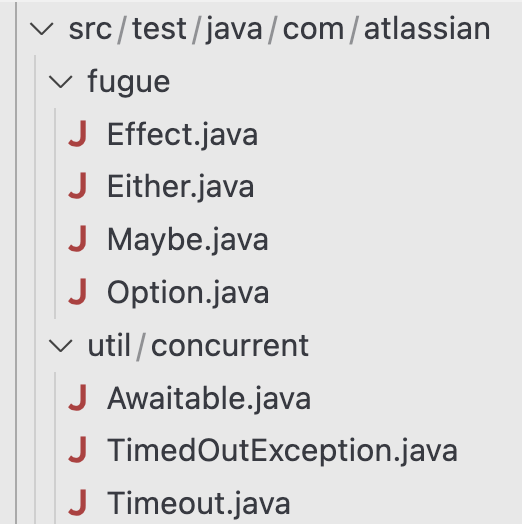

Hey @clouless, how did you solve the issue with com.atlassian.fugue? I got the same issue with AttachmentManager as it consuming com.atlassian.fugue.Maybe in Confluence 8.8. Mind sharing your workaround? Thanks!
Hi @Leon ,
As mentioned somewhere before I have built my own compat-lib and included it as scope=test.
I stripped the implementations from inside the functions and stripped it down to simply be an empty skeleton of classes, just enough to satisfy the test/compile.
If it is just the fugue, you could more easily try this approach instead of building your own compat lib:
:one: Create these files in src/test/java (TEST not MAIN!)
:two: Here is the src as zip:
https://clouless.github.io/atlassian-community-share/2024-confluence8/confluence8.8-fugue-compat-src.zip
I hope this helps.
