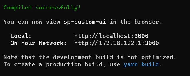

  4. Start the development server of React App (normally by npm start) and the forge tunnel. No matter in which order you start them, but they both should be running at the same time.
  5. Go to the Atlassian Site and refresh the Custom UI page. Now each time you make changes to the React code, you should see the React terminal is re-compiled and the IFrame refreshed (Only the IFrame of the Custom UI is refreshed, not the whole Atlassian page)

To make sure that Tunnel is working with React Development Server
If you open the page where Custom UI is running (or refresh it), you should see this in your Forge Tunnel Console:
It makes sure that your Custom UI resource is loaded from localhost:3000 - your current development server.
The changes to React Code only trigger the React Console (which was started by npm start)
If you made changes to the React code, you will not see the re-bundle in the forge tunnel console, this re-compile is only showing in the React Console.
