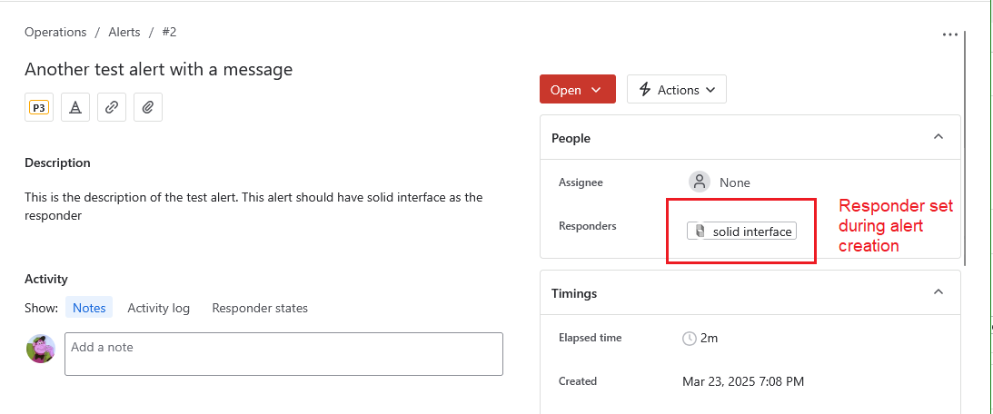

Hello @SudeepPaul
I just got home and ran a test of the JSM Ops Create an Alert endpoint against my personal JSM Cloud instance and the request correctly created the alert and set the Responder at the same time.
  1. Sending the POST request with all the parameters in the body:
  2. The resulting alert in JSM Ops with the Responder set:
So, now that we’ve proven that the API endpoint works as documented, we know you have some other more fundamental problem happening.
There was a mistake in the JSON request body you originally provided that would have made the request invalid, but you’ve since altered your original post and fixed that.
I recommend that you test the same request with an API test tool like Postman, then have a peer at Atlassian double check everything you’re doing.
