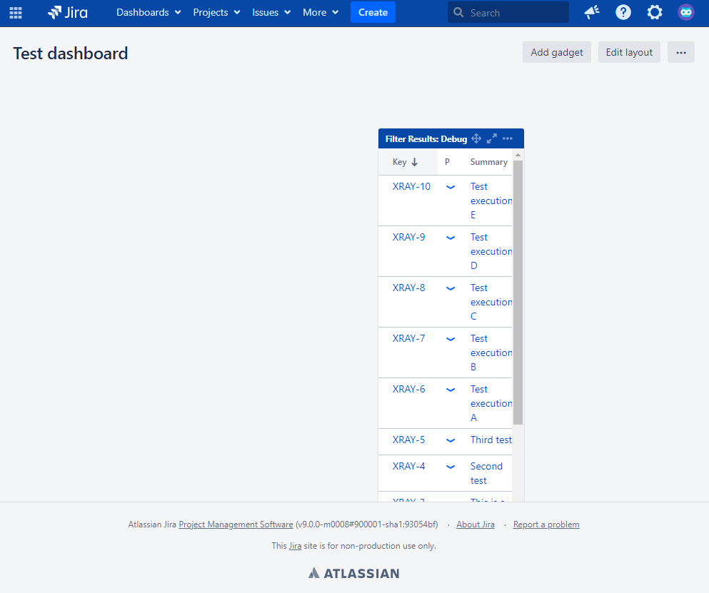

Hi @TomaszPrus
The EAP02 contains a major regression related to Jira dashboards. It’s basically not possible to configure a dashboard anymore. As soon as you try to drag & drop any gadget, it remains “hanged” in a weird position.
Is this problem known? If not, can we report this anywhere?

Thanks Dan! Our teams are already on working to resolve the issue

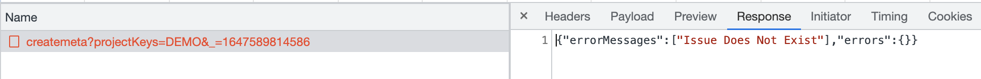

Hi,
createmeta REST API breaks on EAP02. It returns 404 error now.
As far as I know, EAP01 worked correctly. Is there any change on EAP02? I could not find any information about createmeta in Preparing for Jira 9.0 | Atlassian Support | Atlassian Documentation.
Thank you.
Hi,
Reply to Jira 9.0 has a release candidate! - #26 by hirota.takayuki.
You can replace it with this one - "issue/createmeta/projectKeyOrId/issuetypes/issuetypeId. jira-rest-java-client-core has a method for it but it is not parsing the id correctly and it is null. It is expecting id but in reality it is fieldId. The method is IssueClient.getCreateIssueMetaFields.

@nstanishev Thank you for your reply.
@TomaszPrus I found the article about createmeta. I think it would be helpful that Preparing for Jira 9.0 involves this topic.
Thank you.
