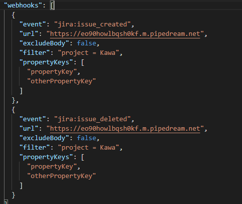

I create new page on jira and want to receve and show whats going on my website (via API) - i mean that new issues are created, updated etc. As via the administration panel - we set what events are to be sent to a specific URL.
The intention is that all the time while the application is running, webhooks with actions that will happen during this time - on a regular basis

-I started with the installation of the basic ACE application.
-I add webhooks to the Modules:
-Set Scopes to READ
-I started it and only when it was able to send the webhook is when I restart the application.
I also tried other ways …
(Will send in next comment - limits)
But somehow it doesn’t work for me - I must have made mistakes that eyes hurt.

I think that the reason why your webhook registered via descriptor is not delivered is a mismatch between app base url and the url where the webhook is sent.
That requirement is documented on that page, however it can be easily missed out.
Specifies your add-on’s POST webhook handler URL. This property must be a URL relative to the add-on’s baseUrl.
To solve the issue, I recommend to implement an easy endpoint in your app that will proxy the webhook to Pipedream.
The only thing that makes me confused it that you said that some webhooks were delivered. Can you elaborate on that case?

Hello @BeataSzturemska ,
About https://developer.atlassian.com/cloud/jira/platform/modules/webhook/ - could you send me some examples of using this ? Because i didnt get it … and the “Recipe” is missing.
How to imprement endpoint in my code ?
“The only thing that makes me confused it that you said that some webhooks were delivered. Can you elaborate on that case?”
Yes thats true - When the application works and i create an event, the webhook with the delayed data is sent when restarting and restarting.
