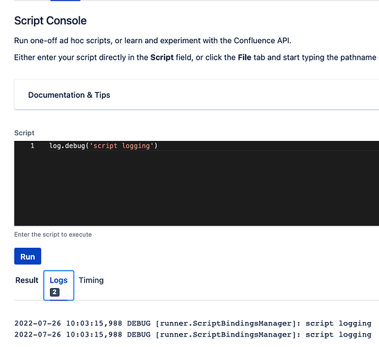

Hi,
I work on the ScriptRunner for Confluence team and we are looking for help with the Log4j 2.x upgrade.
We currently use many exported packages from Log4j for our logging implementations, which power some of our core features. Some of these packages (e.g. org.apache.log4j.spi) will no longer be exported in Confluence 8, breaking our usage our ability to dynamically create log appenders. For example, the ability for customers to use debugging statements in their scripts will break:
There is no equivalent way that we can see to provide the same functionality using SLF4J, since it doesn’t control appenders. Can you elaborate on decision to remove access to the Log4j 2.x API for
plugins?
Thanks!

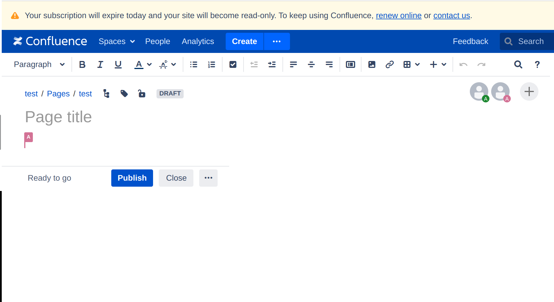

I tried the 8.0.0-struts-m020 version of the EAP. For me the basic Page Editor’s layout is broken:
Am I missing something for that EAP?
Hi @RomanStoffel,
  • For H2, please see Preparing for 8.0 page for H2 support unbundling. AMPS 8.6.0 or later is required to use these removed databases on Confluence 8.0
  • For Struts, yes its a known issue with editor, you can track this item for its fix and can expect a fix in next Struts EAP.
