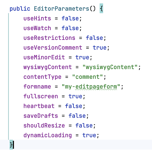

Hi!
Does anybody know how to open own editor?
I opened my own editor. It’s working, but after 30 seconds I have this error message.
Looks like, it depends on the collaborative editing. If I override method AbstractEditPageAction.isCollaborativeContent then I don’t have this error .
public boolean isCollaborativeContent() {
        return false;
But two people can override changes each other and I can’t detect conflict.
Is there any way to solve this error?
Maybe I should provide some params or tokens for synchrony or something like that? (only my guess)
You can see my params, error and how I use editor macro.
I use editor macro
It works without additional params in Confluence 8.
Kind regards
