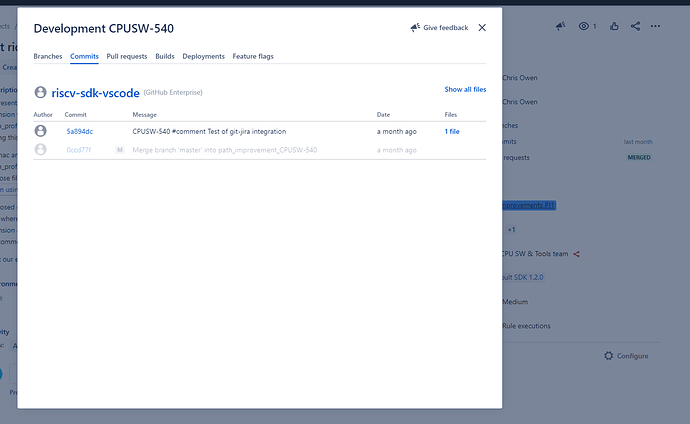

I would like to move the location of a Jira connect app I wrote to either inside the ‘development’ sidebar or mimic the behaviour. I can not figure out how I would place data there or even mimic the details in the sidebar that open a dialogue.
I would like to add details for another SCM into this Development area. Or at worst show the same in a different label. Development seems to be a custom field, but I am not sure I can add to it.
At worst, I just want a button in the sidebar that would open a dialogue like development does:
Currently, I just display my app as a web panel. But we would prefer it tidied away. I have tried to create a webitem/dialogue combo but that didn’t work.
