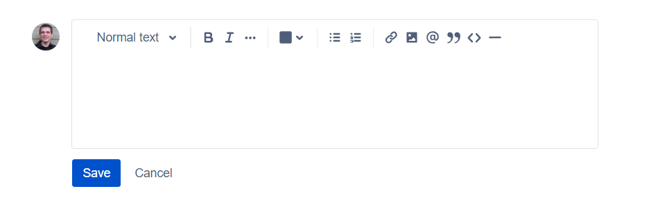

2) Multi-line custom field inconsistency
Multi-line custom fields work better than single-line fields. They accept, stores and returns ADF document objects consistently.
The problem I have found is in the UI. For some reason, the UI doesn’t show the “richness” of the field and the UI editor is not rich either.
Some screenshots of the multiline custom field next to the similar environment field that does accept rich text in the UI:
Are multiline fields going to be rich? Or just plain texts that allow new lines? Should the rest work with ADF objects or strings? Again, If the UI is not rich, v3 rest should work with plain strings
