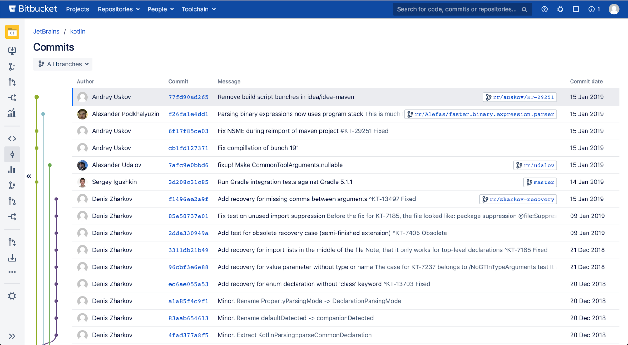

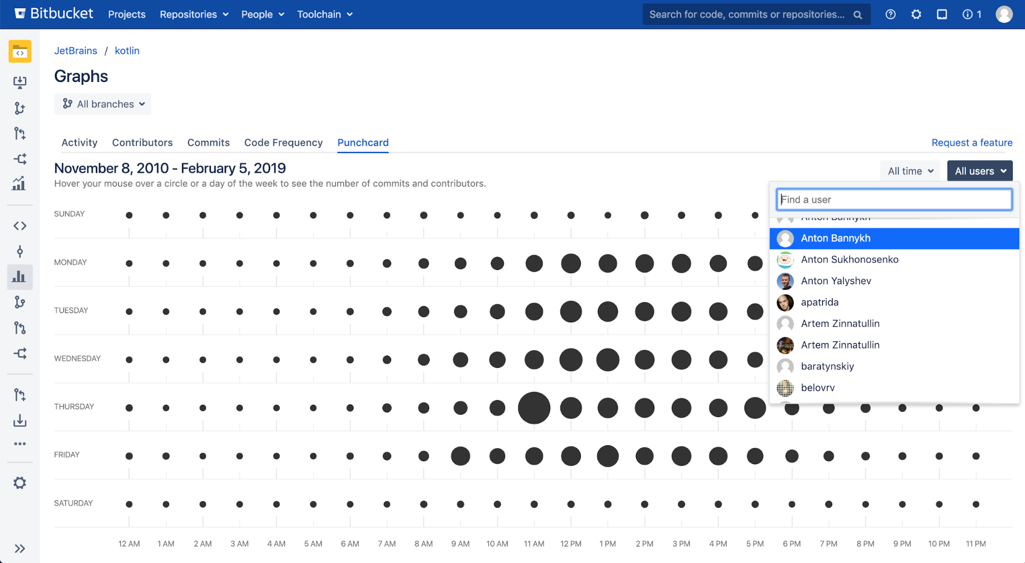

Dear Atlassian team!
Thank you for sharing the EAP release.
We are StiltSoft, Top Platinum Vendor, developers of Awesome Graphs for Bitbucket Server.
Your internal JS API is great, and our app heavily depends on it.
We kindly ask you to make some modules a part of your public API and temporary not to remove them:

Example 1
Our app shows the commit graph with all branches together.
To implement this feature we need that the standard component bitbucket/internal/feature/commits/commits-table
gets data from our API
For this purpose we redefine the method buildUrl in this way
define('page/awesome-commit-graph-table',
    ['jquery', 'graph/navbuilder', 'bitbucket/internal/feature/commits/commits-table'],
    function ($, nav, CommitTable) {
        'use strict';
        function GraphsCommitsTable() {
            CommitTable.apply(this, arguments);
        $.extend(GraphsCommitsTable.prototype, CommitTable.prototype);
        GraphsCommitsTable.prototype.buildUrl = function (start, limit) {
            return nav.commitsGraph().withParams({start: start, limit: limit}).build()
        return GraphsCommitsTable;
Then while loading the page we replace the standard realisation by ours.
requirejs.config({
            map: {
                'bitbucket/internal/page/commits': {
                    'bitbucket/internal/feature/commits/commits-table': 'page/awesome-commit-graph-table'
Example 2
bitbucket/internal/widget/searchable-selector is used to show the selector of committers on one of our graphs
Good to know - thanks for the details.
Please do note that this is very much not supported and your commit graph could break in any release. If this functionality is essential, I’d recommend finding a way to inject your graph without touching any of the existing code on that page. E.g. create a div next to the table that you populate with the graph. You can either use a second REST request to get data or you can add a at bitbucket.commits.extras with a web-panel at my-key (or whatever you use for the section key). This will add a column to the table, which you can style to be 0 width, but the web-panel will get information about each commit, which you can then use to render your graph. You can use the web-panel being rendered to trigger an update of the graph too (e.g. by rendering , then updateGraph would use debounce() so that even though a page of commits calls it 25 times - once per commit, the graph is rendered once with all 25). This isn’t the prettiest code, but it should be more robust since you’ll be using supported APIs. The div you add could still be broken since our DOM isn’t API either. But at least the unsupported surface area is lower.
Would user-multi-selector work here? Or do people mostly only search for themselves? Could a toggle for “Only my commits” work?
