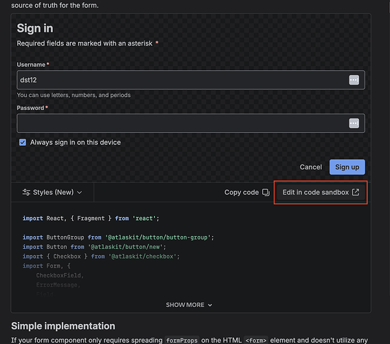

Hi Alp, would you mind sharing a minimal reproduction (preferably by modifying one of the code sandboxes from the Atlassian Design System Website) to make it easier to debug :slight_smile:
