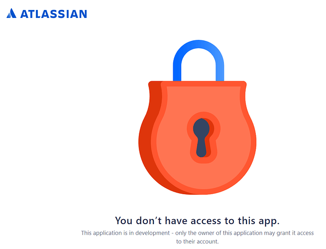

I then proceeded to click the “Allow access” button, which took me to the following page:
Which is obviously a problem.

For some reason, even when I use my own user - instead of the service account - to create, deploy, and install an app/plugin, I still can’t see it working on Jira and am prompted this message:
And what happens when you Allow Access?
I’m taken to that orange lock screen
Hi LucasXavierFerreira :wave:, I think what happens to the app is that access is restricted to the app owner. If you want to access it with a different user, you may just have to “share” it going in the distribution settings in the Developer Console. Let me know if that’s helpful?
I changed its settings from “Not shared” to “Sharing” and still it didn’t work
