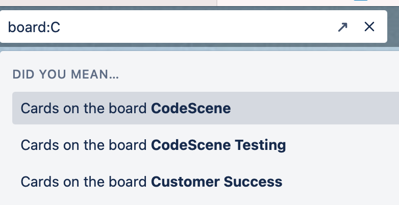

Not sure what you mean by that, but I found this thread because I had the same problem as the reporter. That is, an API query for cards on boards with query string "board:\"BOARD-ID\"" that previously worked now returns no cards. So I tried the same thing in the UI with the same result - very simple, just a search specifying a board and nothing else. I don’t even have to write the complete query, just select one of Trellos suggestions

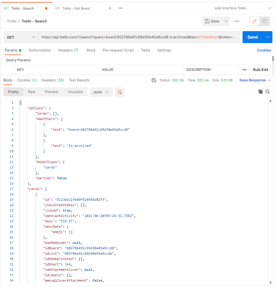

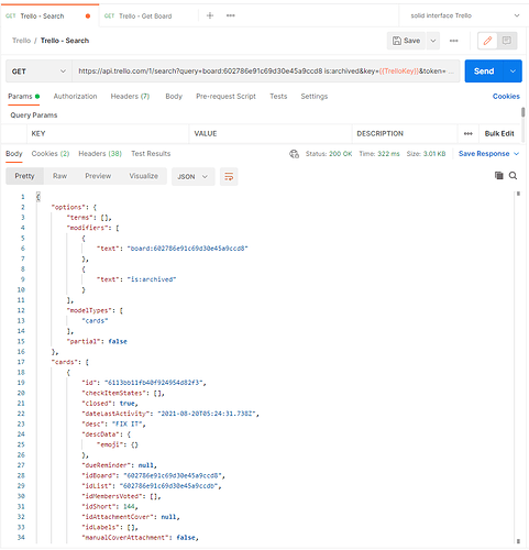

I can confirm this same fault. A search via the REST API for all cards in particular board, using that board’s ID or name, will return an empty array for the cards:
However, if another modifier is added to the search, then the search works and the array of cards contains values:
The exact same fault can be replicated via a search using the web interface:
…with the extra modifier:
I suggest you log this as a Trello bug.
