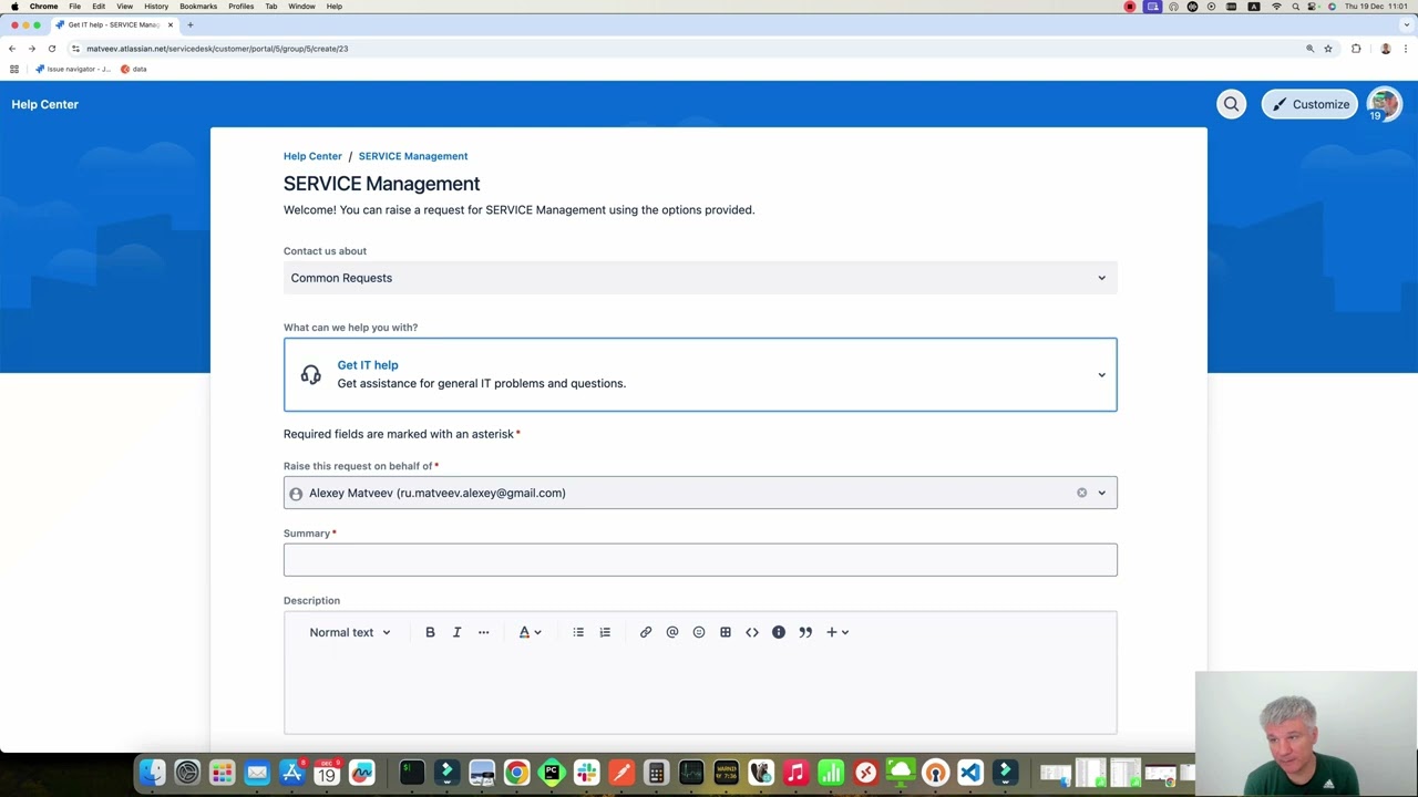

Hello! I created a video on how to add custom fields to the portal with Atlassian Forge.
The source code of the app is here:
https://bitbucket.org/itsuperhighway/forge-portal-request-property/src/v.1/
And here is the video:
