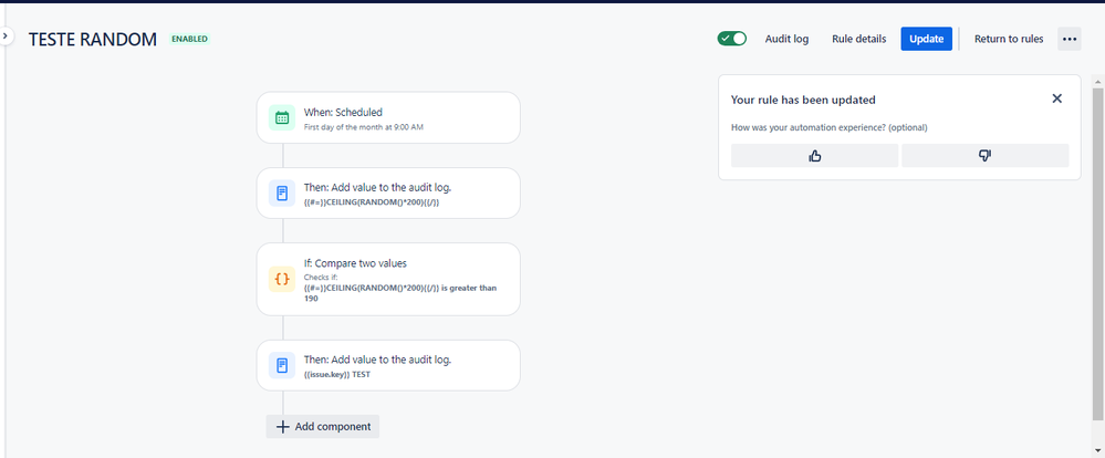

This is my automation:
https://community.atlassian.com/t5/image/serverpage/image-id/315245i63D0C2C8F5F6F96D/image-size/large?v=v2&px=999

Also, upon checking your automation, in order to have a consistent result in your math expression, I’d recommend the use of variables (see image below). In your automation, the random number in the 2nd component has a big probability that it is different from the random number generated in the 3rd component (the if condition component).
