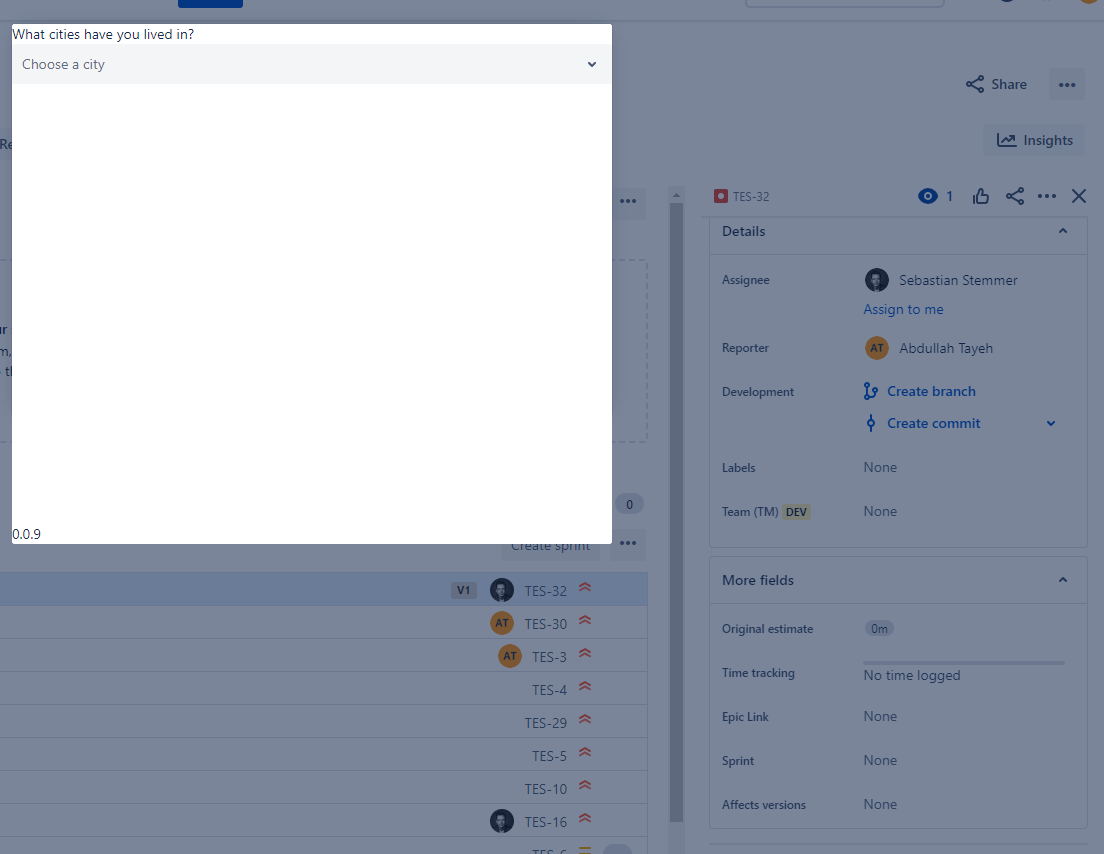

@kkercz thanks again for your reply, I did point it to a resource where I just show an Atlaskit Select element:
Which I am guessing is the right way of doing this. I then fetch the stored fields to render as options, and figure out how to submit the values (with view.submit(fieldValue) I am guessing).
That is really a chore, and the UI looks suboptimal, I am guessing the modal has to be there?
Yes, I’m afraid that on the issue view, editing in a modal is the only option.

Just tried it out, it works, but I oversaw something, the modal is not shown on the issue CREATE screen, but is still shown on the issue EDIT screen.
That’s correct, issue create has inline edit, but issue view supports only the modal dialog. That’s the case for both Custom UI and UI Kit.
