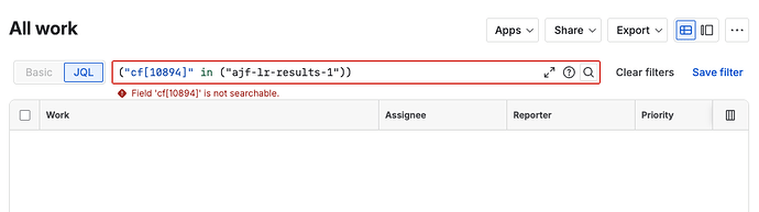

When I try to search by my custom field in Search work items, I get the following error:
However, when I check the field via the REST API, the field’s attributes show searchable: true.
So the UI says it isn’t searchable, but the API says it is.
The field context below:
What could cause it?

It seems the problem occurred due to a mistake I made in the code. The issue is now resolved. I’m currently testing an app I’m developing with a large number of issues, and these tests take quite some time. Because of that, even when I fix a problem, I sometimes notice it a bit late.
