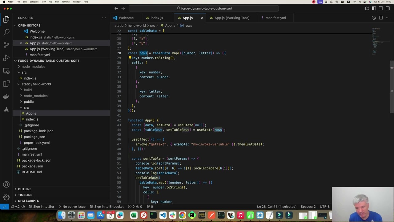

Hi @mabo
Here is an example of a custom sort for DynamicTable component. You can find a working example here:
https://bitbucket.org/itsuperhighway/forge-atlaskit-dynamic-table-custom-sort/src/v.2/
and detailed explanation here:
import React, { useEffect, useState } from "react";
import { invoke } from "@forge/bridge";
import DynamicTable from "@atlaskit/dynamic-table";
const caption = "Example issue with DynamicTable";
const head = {
  cells: [
      key: "number",
      content: "Number",
      isSortable: true,
      key: "string",
      content: "String",
      isSortable: true,
const tableData = [
  [1, "d"],
  [2, "c"],
  [3, "a"],
  [4, "b"],
const rows = tableData.map(([number, letter]) => ({
  key: number.toString(),
  cells: [
      key: number,
      content: number,
      key: letter,
      content: letter,
function App() {
  const [data, setData] = useState(null);
  const [tableRows, setTableRows] = useState(rows);
  useEffect(() => {
    invoke("getText", { example: "my-invoke-variable" }).then(setData);
  const sortTable = (sortParams) => {
    console.log(sortParams);
    tableData.sort((a, b) => a[1].localeCompare(b[1]));
    console.log(tableData);
    setTableRows(
        cells: [
            key: number,
            content: number,
            key: letter,
            content: letter,
  return (
    <div>
      {data ? data : "Loading..."}
      <DynamicTable
        caption={caption}
        head={head}
        rows={tableRows}
        isFixedSize
        onSort={sortTable}
    </div>
export default App;
