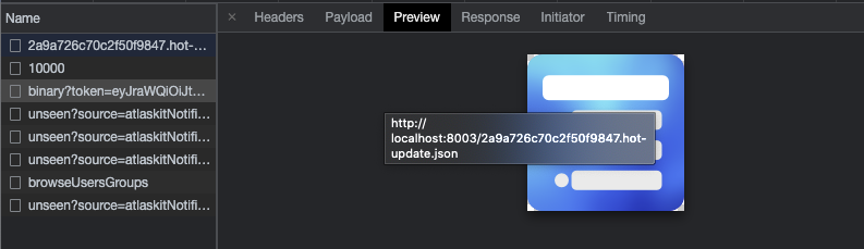

The dev tools show that the Forge bridge downloads a file. But its content seems to be broken. Maybe the content gets corrupted through the PostMessage API Forge uses under the hood?

More information about my analysis: when the Custom UI client calls the api endpoint (see code above) the following things happen:
  1. The inner iFrame tells the host frame via postMessage to make the according call.
  2. Then the host frame makes the according request for our iFrame which results in a redirect (303)
  3. The outer frame follows the according redirect and downloads the image. Chrome shows the image, everythings is fine until here
  4. Now I assume annoying things happen. The host frame passes the response back to our iFrame via postMessage api. According to the chrome logs this data is corrupted (see the ��� at the bottom).
I’m not entirely sure but I guess the Forge magic that happens in the host frame should convert the data to base64 first before passing it to the postMessage API (which isn’t compatible with binary data like images).
