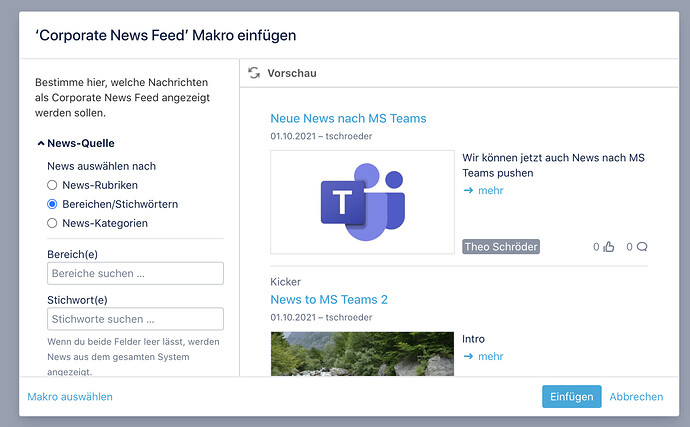

Does it have to be an iFrame? There is a function to customize the macrobrowser dialog completely if that’s what you need. So your macrobrowser dialog would look like this here:
With this kind of customization, you would lose the preview on the right side. If you just need to customize the left side, you could achieve something like this here:
Here you can see that we’ve customized all inputs on the left side. It would be easy to replace the complete left side. But what would happen to your macro parameters? They need to be saved and synced with the macro itself. I could write you a function which replaces the left side with an iFrame…
