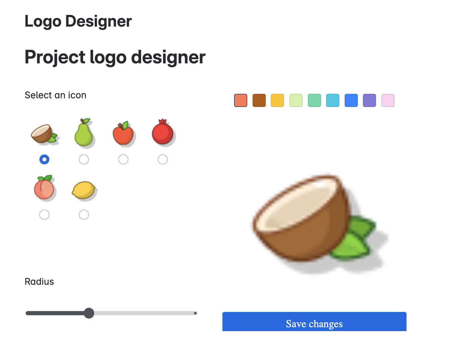

Hi, @SolomanWeng,
I followed those steps and I got the frame component to show on screen. However, it seems to be a little broken, at least the design is, as you can see in the image. In addition, in order to get the frame component to show up I had to use my original code with createRoot(), and not follow @AaronCollier suggestion.
Thanks for the help!
Rodrigo
Hi, @RodrigoRodrigues nice! you have done the correct setup here.
With React 18, you do have to use
import { createRoot } from 'react-dom/client';
as you suggested. We will also review the documentation to see if we should adapt for React 18+ as well.
The code inside Frame resource are can be done through any javascript framework (any React version, Vue.js, etc.), hence it is up to the developers to setup them up properly.
I assume you mean the stying seems not to be applied properly, it could be that there are some additional setup you need to do to configure the ADS component library properly, maybe you could check a bit further on (Overview - Marketplace partners - Atlassian Design System) .
This, tutorial mainly focuses on setting up a Frame component in the UI Kit app, hence there could be some minor details missing that are not directly related to the topic. But we will also have a review on our example repository to ensure it should work as expected.
Thanks so much for reaching out and communicating how you setup the code for React 18 :heart:
