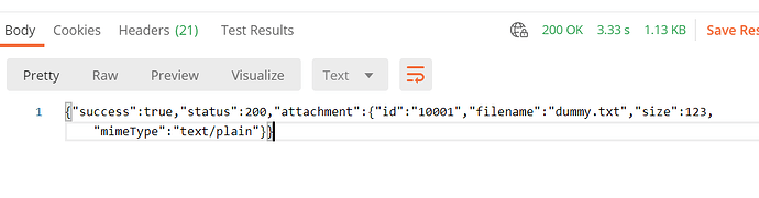

Hi
Solution :
Even I faces this While working on web trigger .
Only we have to send response in specific format
Example:

    return {
      statusCode: 200,
      contentType: "application/json",
      body: JSON.stringify(data),

Also @BrettB here is detail solution for your request also:Webtrigger returning 424 Failed dependency
Do check and if Faced any issue let me know .Because its working for me
Thanks!!!
thanks @NishantParaskar2 this worked.
