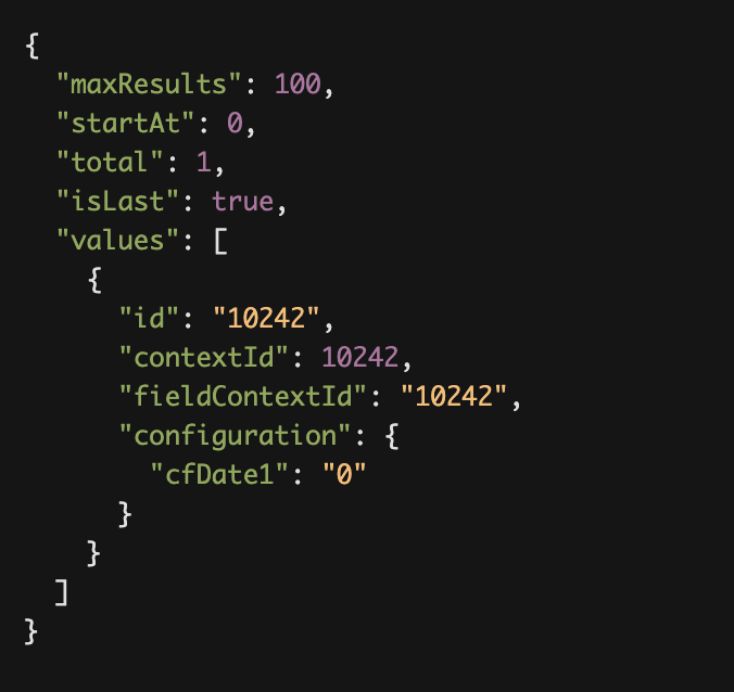

I checked from my browser and I get this result when I was requested for /rest/api/2/app/field/customfield_10142/context/configuration :
and this is my current view.jsx:

      <Text>Hello, {ids.values.configuration.cfDate1}</Text>

@AliMert, your code looks good. If it doesn’t work because of permissions to the API, try making the request .asApp() instead of .asUser().
@mikhail.gorev, the API to fetch the configuration is available only for admins, so you will need a resolver.
