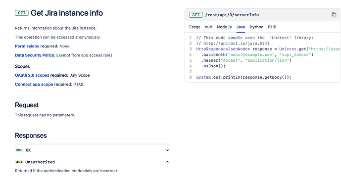

Hello @anon96974232 , I went through this already but It says that it required authentication or else will return 401 if the authentication credentials are incorrect.
I tested for few cloud instances and it worked without authentication, but need to be sure on that will it work for every instance without authentication.
Secondly, I want to know if this is the common API that can be used to get serverInfo for DataCentres also. As for this I got this but it doesn’t tell much about response structure and authentication requirement : https://developer.atlassian.com/server/jira/platform/rest/v11000/api-group-serverinfo/#api-group-serverinfo
You need to re-read that documentation again, as it says the exact opposite :
Returns information about the Jira instance. This operation can be accessed anonymously. Permissions required: None.
If an endpoint can be accessed anonymously and requires no permissions, that means the endpoint doesn’t require any authentication..nothing..zero…zilch…zip..nada.
Which of course proves that the endpoint works exactly as the documentation says it does.
but I need to be sure on that will it work for every instance without authentication.
What makes you believe the endpoint’s behaviour would randomly change for other Jira Cloud instances? It would be more logical to start with the assumption that the endpoint behaves in the same way for all Jira Cloud instances.

Actually, It’s confusing with the response mentioned as 401 also.
A 401 Unauthorized response is common for both Jira Cloud and Jira Data Center because it simply indicates an authentication failure and does not help identify the deployment type.
