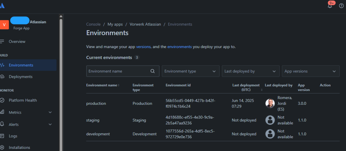

I’ve created a Rovo agent and deployed it to production, as shown in this screenshot:

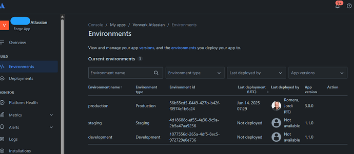

However, when another user tries to interact with the agent, they receive an error saying authorization is required, as you can see in this screenshot:

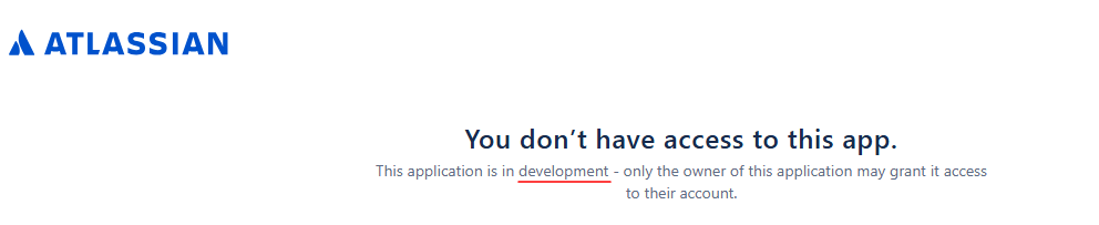

In the third screenshot, it says the app is still in development, even though I’ve already run the following commands:

Yes. It looks like the docs on the limitations of different environments is missing some content. Specifically, apps in dev don’t work for anyone but the dev who built it. As such, the behavior you observed is expected for the development environment. For production, your screenshot confirms the correct deployment to production so I think @aagrawal2 is correct:
No. Use the distribution option.
Marketplace is for public apps. Use the distribution via installation link option for “only within your company”.
