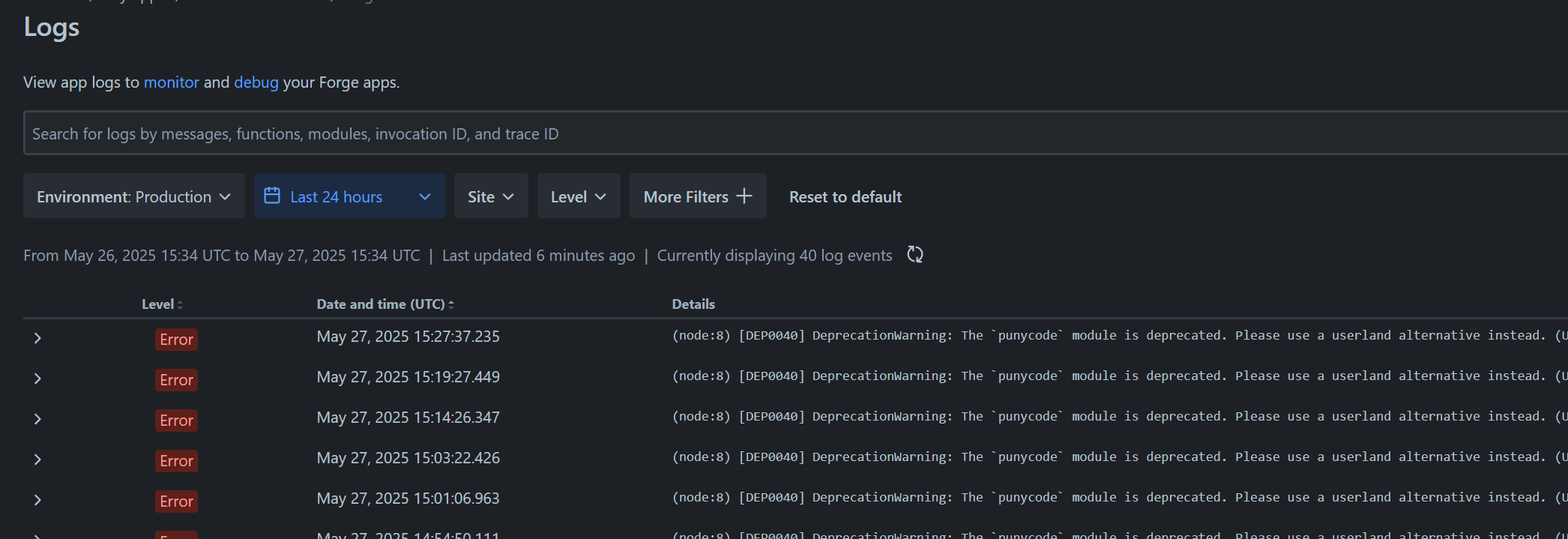

I do want to point out that this only affects local development and will not affect your apps running in Forge functions
It is currently affecting my app running in Jira outside of local development. See below:
