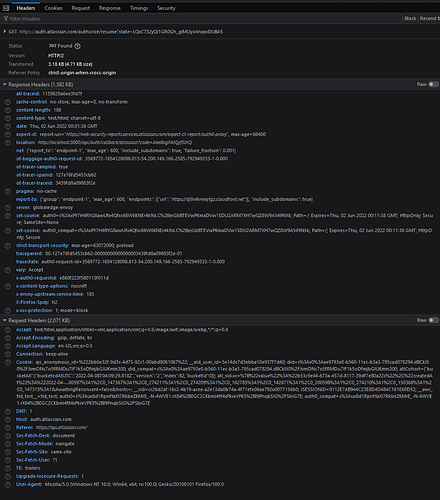

Ok, thanks to @CarlosALpezOrtn for reminding me to look at the actually HTTP responses.
The problem would appear to be a Next JS, Next Auth error.
This is the success header when Atlassian redirects back to my localhost. Below in a second post as I can only post one image per post, is the failed header, as you can see, they are both exactly the same. Therefore the problem lies within Next JS Auth library, which I will now debug to try and find the issue.
