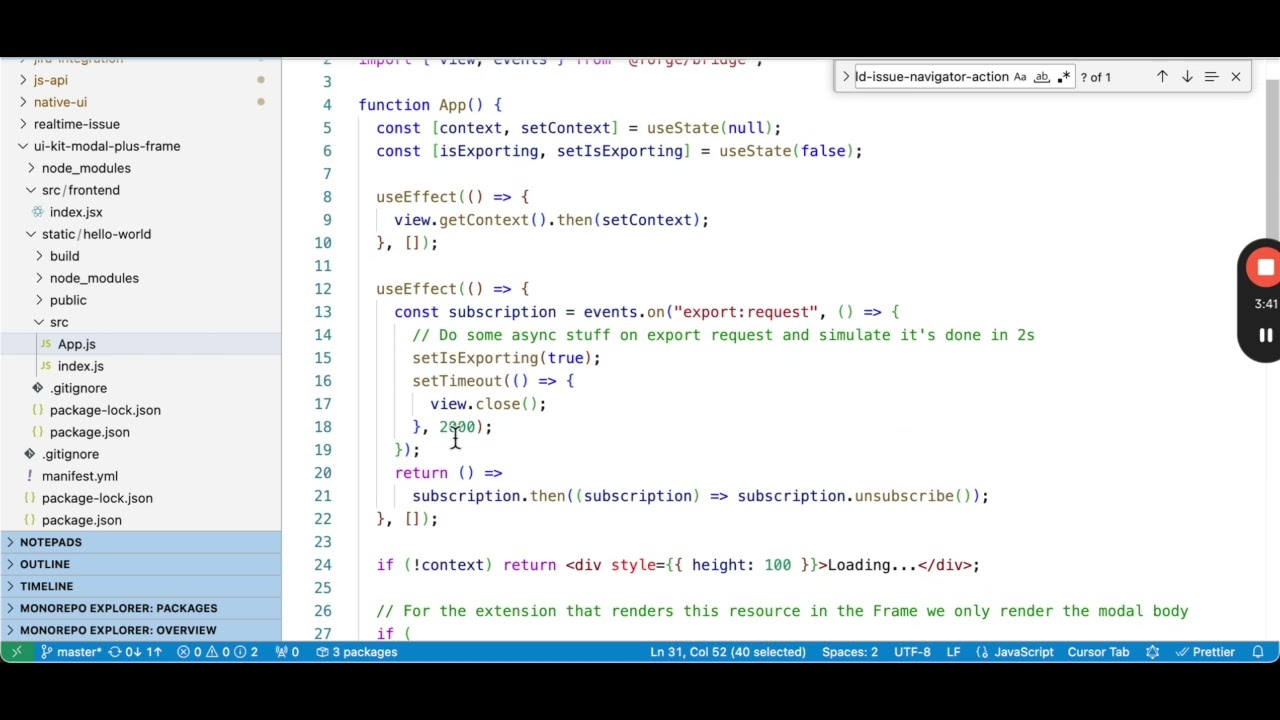

I’d suggest going with a actionType: dynamic UI Kit component where possible because it allows registering custom modal controls that are properly positioned, which results in the best UX. If that’s not possible e.g. because of the (temporary) missing features in UI Kit, I have created an example app snipped and recoded a video explaining how to render Custom UI inside the UI Kit Modal (sorry for the quality, I had to download it and re-upload again):
The app itself won’t be working out of the box when you run forge register, because it misses a few files, but the code is working fine and you may just copy/paste it into your app.
What it does/can do:
- Defines a resource that conditionally renders the modal contents based on the context, so when it is used by the global/project of any other module, it can be rendered as a regular Atlaskit modal, but if it is rendered by the issue navigator action one, only its contents is rendered.
- Renders the mentioned above resource inside the
Modal body utilizing the Frame component.
- Communicates to the Custom UI from UI Kit to perform the action on action button click.
- Automatically resizes the modal height based on the
Frame height.
- Can programmatically change modal size, see docs.

Hi, Vitalii!
Over the past few days, we’ve been testing and experimenting with the code example you provided, trying different approaches to adapt it to our needs.
Your suggested solution would be perfect for a standard modal implementation - and I apologize for not previously mentioning the complexity of our specific case, which you couldn’t have known about.
Unfortunately, this approach won’t work for our use case. The suggested solution proposes using a Forge modal as a container and injecting our content into its body. However, our modal implementation is significantly more complex, with multiple dynamic paths that render different headers, bodies, and footers depending on where the user is in the export process or form flow.
We attempted to use the Forge modal as a parent container while maintaining our Atlaskit Modal components (ModalHeader, ModalBody, ModalFooter) inside it
. However, this isn’t feasible as these Atlaskit components require their parent Modal component to function properly. When we include the Atlaskit Modal, we end up with two nested modals again (Forge and Atlaskit).
Migrating our entire modal codebase from Atlaskit to Forge UI Kit would require a substantial refactor of a critical part of our application. Given that we’ve just launched to production, undertaking such a significant restructuring isn’t viable at this time.
Is there perhaps another approach that would allow us to maintain our existing Atlaskit modal implementation while still migrating to Forge?
Best regards.
Diana.

Hi @dianaaceves,
Unfortunately this is the only way at the moment, it won’t be possible to have Atlaskit modal “as is” rendered without any additional work, I’m sorry for that. However, I’ve got another idea and will get in tough with the team, perhaps we could figure something out. I’ll provide an update when I have one.

Hi @dianaaceves,
Just confirmed with the team that another idea I had won’t work. At this point the initially suggested way to resolve it by placing only modal body to Frame component and implement both footer and header on the UI kit side using the event system for communication is the best way to solve your use case.
I’d also suggest to raise a public ticket describing your problem in a more general way so other developers could vote for it.
