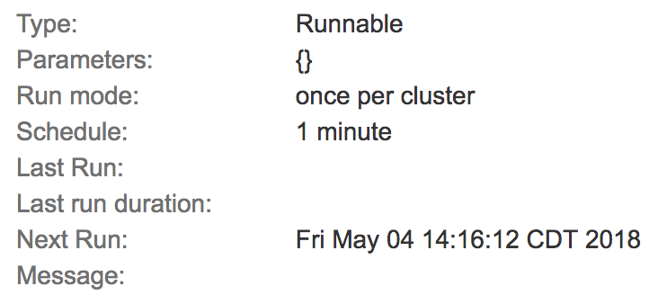

I’m scheduling a job to run on an interval. I want it to run right away, then every minute after. I can see that the job is being scheduled, but it never runs. The “Next Run” time in “Scheduler details” shows the time the job was first scheduled, which is now in the past.

Scheduler details (taken on Friday May 04 14:20):
Unfortunately, as it often goes, I found the answer shortly after posting. Setting the RunMode to RUN_LOCALLY solved the issue.
We are running only one node, so why is this? I would think the run modes would be identical in our case.
