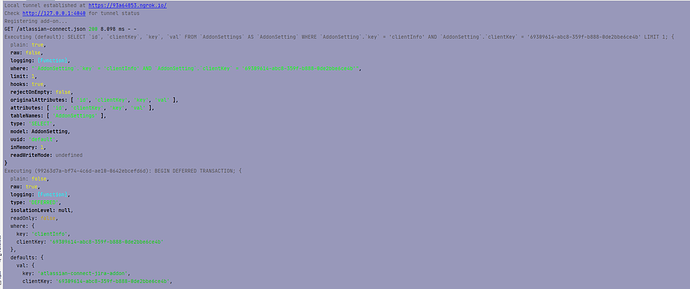

I checked out a fresh project from https://bitbucket.org/atlassianlabs/atlassian-connect-jira-example/src/master/ and this is able to register with my jira instance without a problem. I compared the registration process and noticed following:
On the jira-example-project:
On my project:
Both projects use this database setup (from config.json):
    "store": {
      "adapter": "sequelize",
      "dialect": "sqlite",
      "storage": ":memory:"
The mistake I made was to implement this route:
  // DO NOT USE THIS, BAD CODE
    app.post('/installed', addon.authenticate(), async function(req: any, res: any) {
        console.log(req.body)
        //do something own after installation, nope this is not good!
        res.sendStatus(200);
This does apparently break the first authentication between Jira and the add-on. I did not notice this break, because my dev add-on was already registered with Jira and the authentication was using and entry from a sqlLite file database that was saved before the breaking change. So I did not understand why it “suddenly” broke, because the mistake was made one month back.
