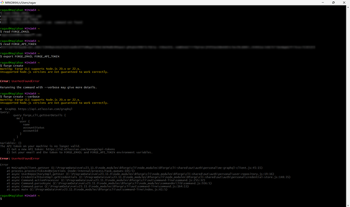

Unable to login to forge
Unable to login to Forge using API Key (Not behind any corporate proxy, using my personal laptop)
Tried by referring,
https://community.developer.atlassian.com/t/unable-to-login-forge/64314
https://developer.atlassian.com/platform/forge/getting-started/#using-environment-variables-to-login
Attached screenshot with details
is this something to be looked upon ?
I am an admin and generated this token using admin email
Additional information:

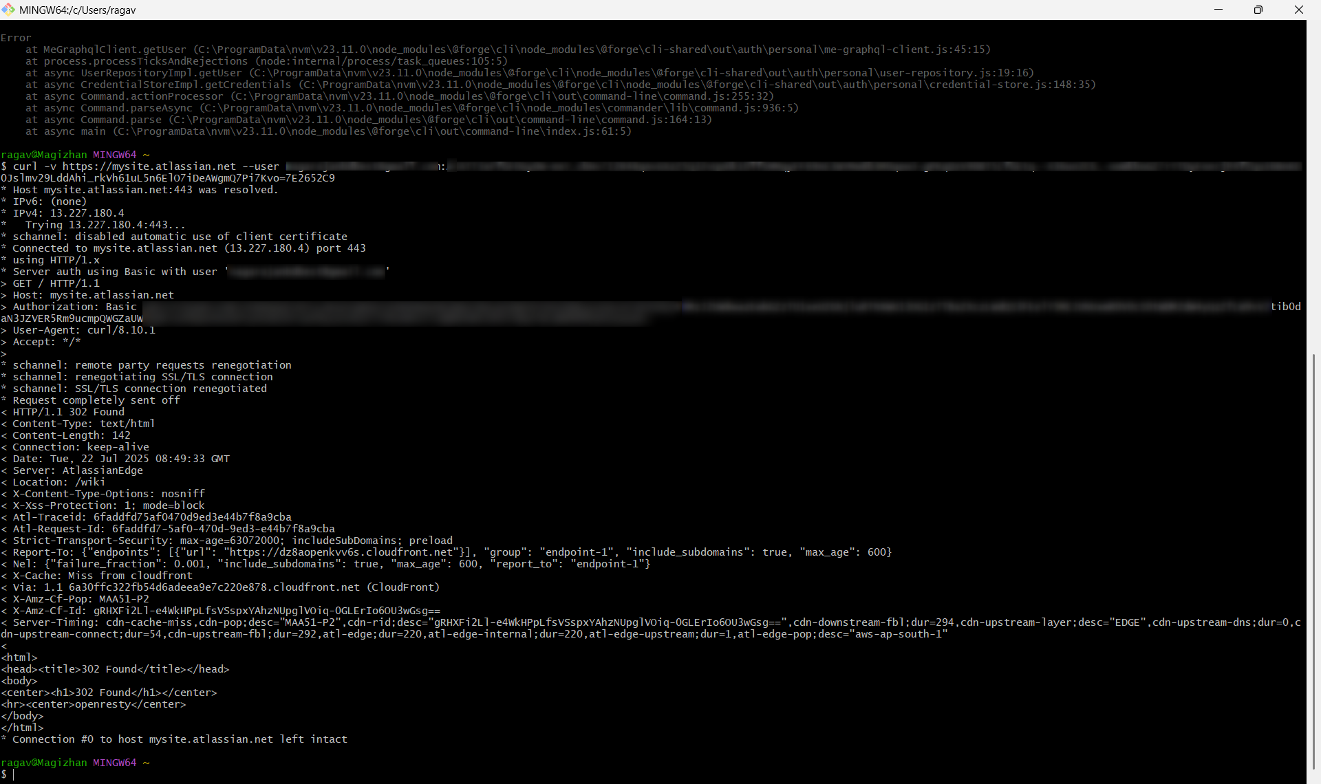

  5. To rule out API key’s access tried CURL with API key and confirmed that API Key was accessed using “Last accessed” field in [Atlassian account]
Curl details here: Unable to login to forge - #2 by NagarajanBalasubrama
Kindly let me know if there is any additional details required from my side.

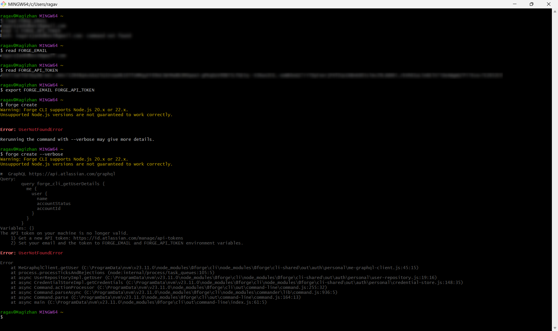

P.S: Tried the below once again after your feedback and sharing the results for reference
Step1:
$ forge whoami
Error: Not logged in. If a local keychain is available, run forge login, otherwise set environment variables before trying again.
Rerunning the command with --verbose may give more details.
$ read FORGE_EMAIL
$ read FORGE_API_TOKEN
$ export FORGE_EMAIL FORGE_API_TOKEN
$ forge whoami
Error: UserNotFoundError
Read “Last accessed” field in security section of the API Token and value is “Never Accessed”
Step2:
Curl -v https://mysite.atlassian.net --user email : API token
Read “Last accessed” field of the API Token and value is “2 minutes ago”
