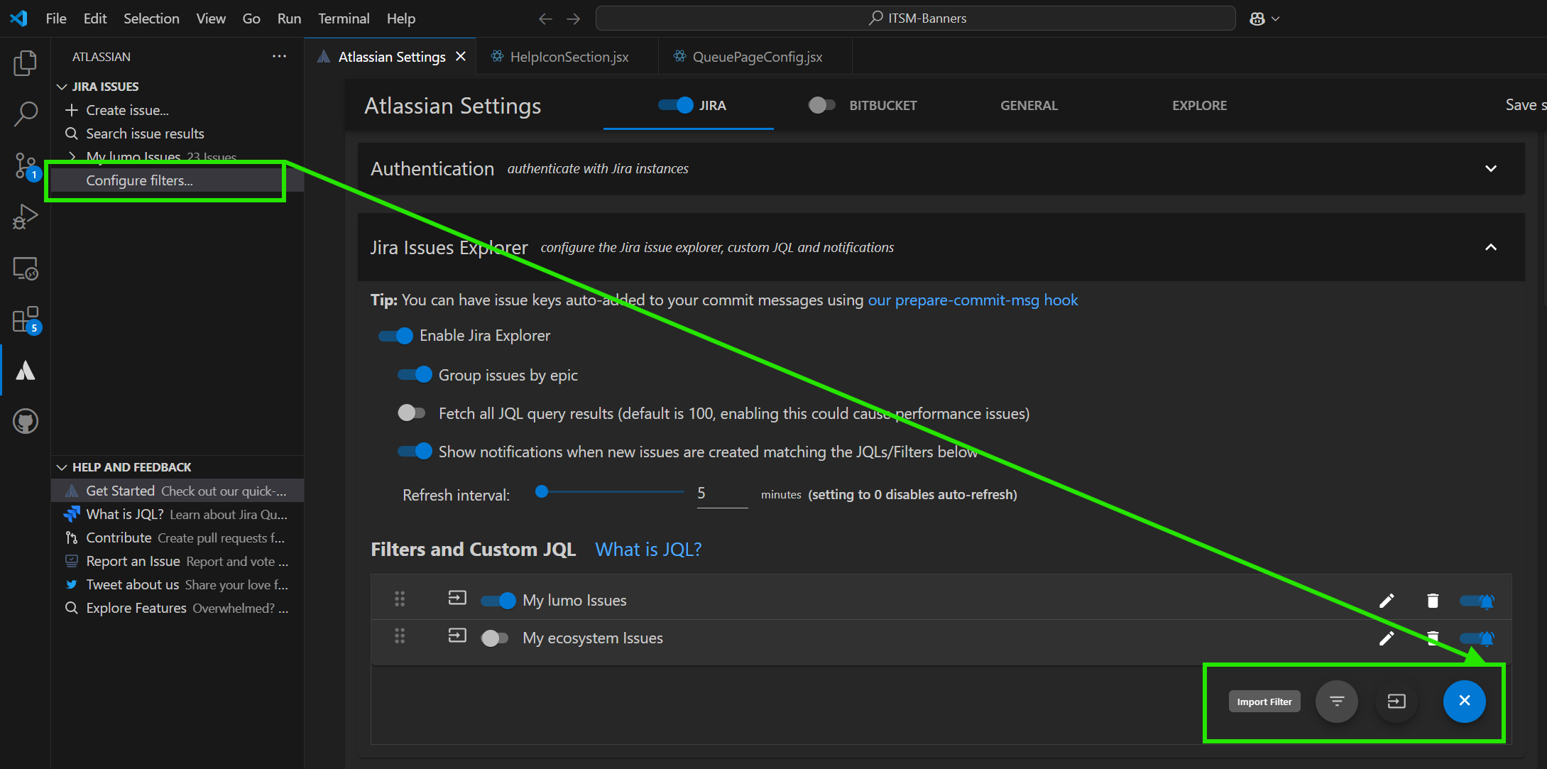

The next few images are me trying to open/create an issue within the VSCode extension. I’ve tried to re-install VSCode, the extension, and I’ve logged out and in many many times. For some reason, it just comes up blank.
[I’m being told that I can’t upload more than 1 media, so all the images are available in the above link.]
It’s worth noting, that when I try to import a filter in settings, it doesn’t display it either
If anyone has any sort of solution so I can start using the extension as intended again, that would be great.

I believe I have solved the issue.
FIrstly, when trying to open issues, you might be asked to install something that seems useless compared to what you are currently doing. Just press “Yes”. This fixed the problem I was having with not being able to open issues.
Secondly, the problem of my issues not appearing was fixed by going to Profile Settings → Connected Apps, then removing access to Atlascode Integrations, like so:
a
Afterwards I removed the link on VSCode, refreshed everything, and re-authed with Jira. This message was to anyone who experiences the issue further down the line.
