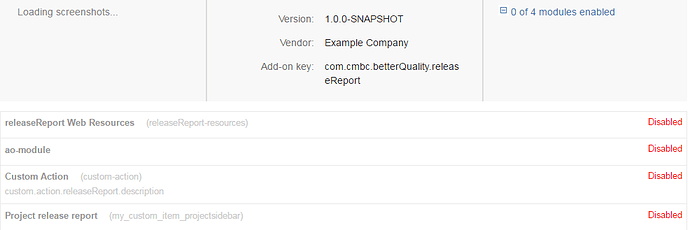

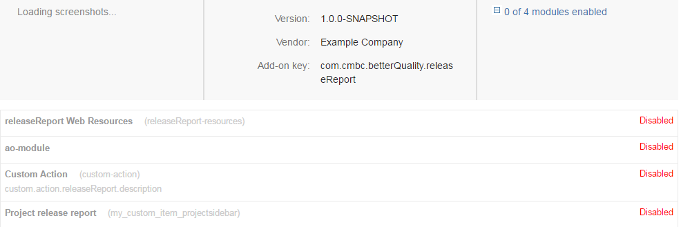

I created a custom JIRA plugin with some component added. But JIRA always failed to start up.
Could you help to figure out the reason? That will be very helpful.

Your plugin uses classes from antlr.actions.csharp, but can’t see that package at runtime.
Can you post the pom.xml file you are using to build your plugin?
