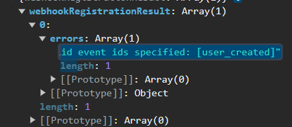

i am having a problem with creating Dynamic webhook with ‘user_created’ as Event.
using jira rest api to create the webhook with ‘user_created’ events returns error Invalid event Ids specified
i ve been following the documentaion Register Dynamic webhook to create the webhook but user_created event doesn’t work as payload.
Is there a way to create the webhook with ‘user_created’ as event using jira restApi?

the Link you provided works for the rest/webhooks/1.0/webhook which requiers authorization…
but the rest/api/3/webhook is the endpoint supported by forge…the ‘user_created’ as payload gives “Invalid event ids specified” error…also every possible format like ‘User_created’,‘User:user_created’…etc , same error
error

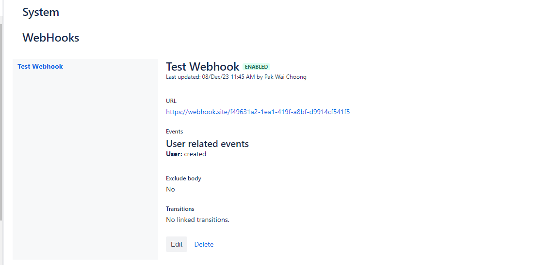

Not exactly sure what you’re trying to after… but it was pretty straightforward…
Here is what I have set following the guide here
As you can see, it detected the event flawlessly without the need of authorization.

the forge api to create the webhook /rest/api/3/webhook doesn’t support the event i want ‘user_created’…
i tried the “user_created” event as payload but it gives the ‘Invalid event ids specified’ error
the only other way i can find to create the webhook is using fetch call to /rest/webhook/1.0/webhook which requiers auth to create the webhook *since forge doesn’t support this endPoint * so it’s not a valid way.
so i am asking if there is a way to create the webhook through api other than the 2 ways i mentioned or a workaround to create the webhook with ‘user_created’ event through this endpoint /rest/api/3/webhook
