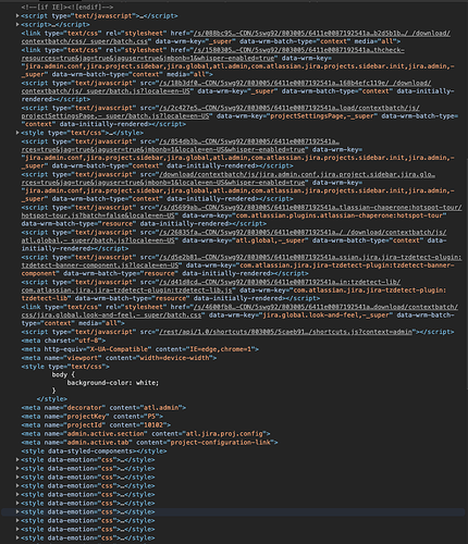

My P2 app uses several AtlasKit components to render a project setting page (atl.jira.proj.config/projectgroup4). Until today, I thought this works without any issues (tested with Jira Software projects). However, if I open the same settings page in a JSD project my styled-components styles are gone (page renders as expected an is otherwise functional).
Unfortunately, there is no error message in the console that would hint on why it is not working. However, it seems that in the Jira Software project styled-components and emotion styles can work together. The head tag on the page contains <style data-emotion="css"> tags and <style data-styled-components> tags…
… in the JSD project, however, there is only a single empty styled-components style tag.
