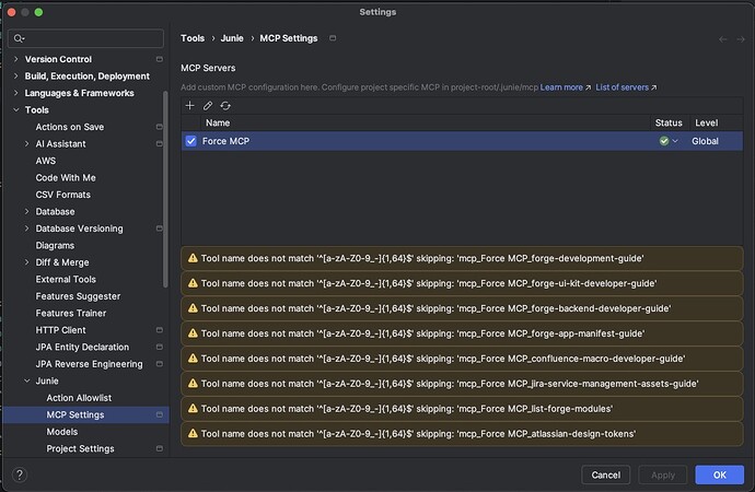

Thanks @BrendanBarlow the workaround seems to work with this configuration.
  "mcpServers": {
    "Force MCP": {
      "command": "npx",
      "args": [
        "-y",
        "mcp-remote@latest",
        "https://mcp.atlassian.com/v1/forge/mcp"
I say seems because the status is shown as ok listing some tools that can be used, but I also see these warnings/error
Is this to be expected because of the lack of direct IDEA support, or is there something else?
@markrekveld It isn’t expected from the Forge MCP server. Our tool names do match the pattern shown in the errors.
I’m no IntelliJ expert, but I’m wondering if the errors are due to the space in the server name, “Force MCP”. It looks like IntelliJ is constructing a qualified tool name that includes the server name. This is just a guess, though.
You called it @BrendanBarlow I updated the name of the server to MCP_Force and wtched all the error disappear.

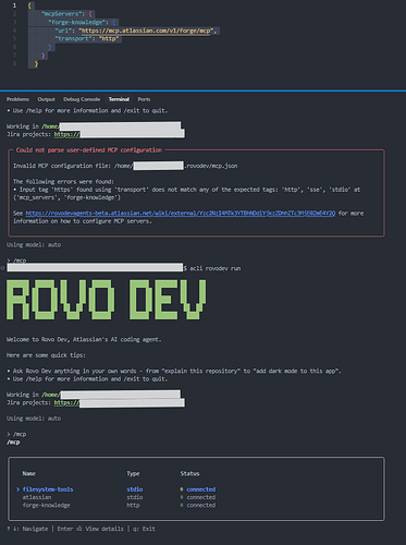

Hi @dusan ,
I’ve been having a little trouble with this myself, but for now have managed to make the connection work with this configuration:
    "mcpServers": {
      "forge-knowledge": {
        "url": "https://mcp.atlassian.com/v1/forge/mcp",
        "transport": "http"
There seems to be a bit of a contradiction between the URL which holds “https” and the transport which only holds “http” for now.
Anticipate this being cleared up? :slight_smile:
Justin
We’ve updated the documentation on our end (https://developer.atlassian.com/platform/forge/forge-mcp/#connecting-your-ide-to-the-forge-mcp-server) to include the correct settings. http is the correct value for both the transport parameter for the Rovo Dev CLI and for the type one is VS Code.
