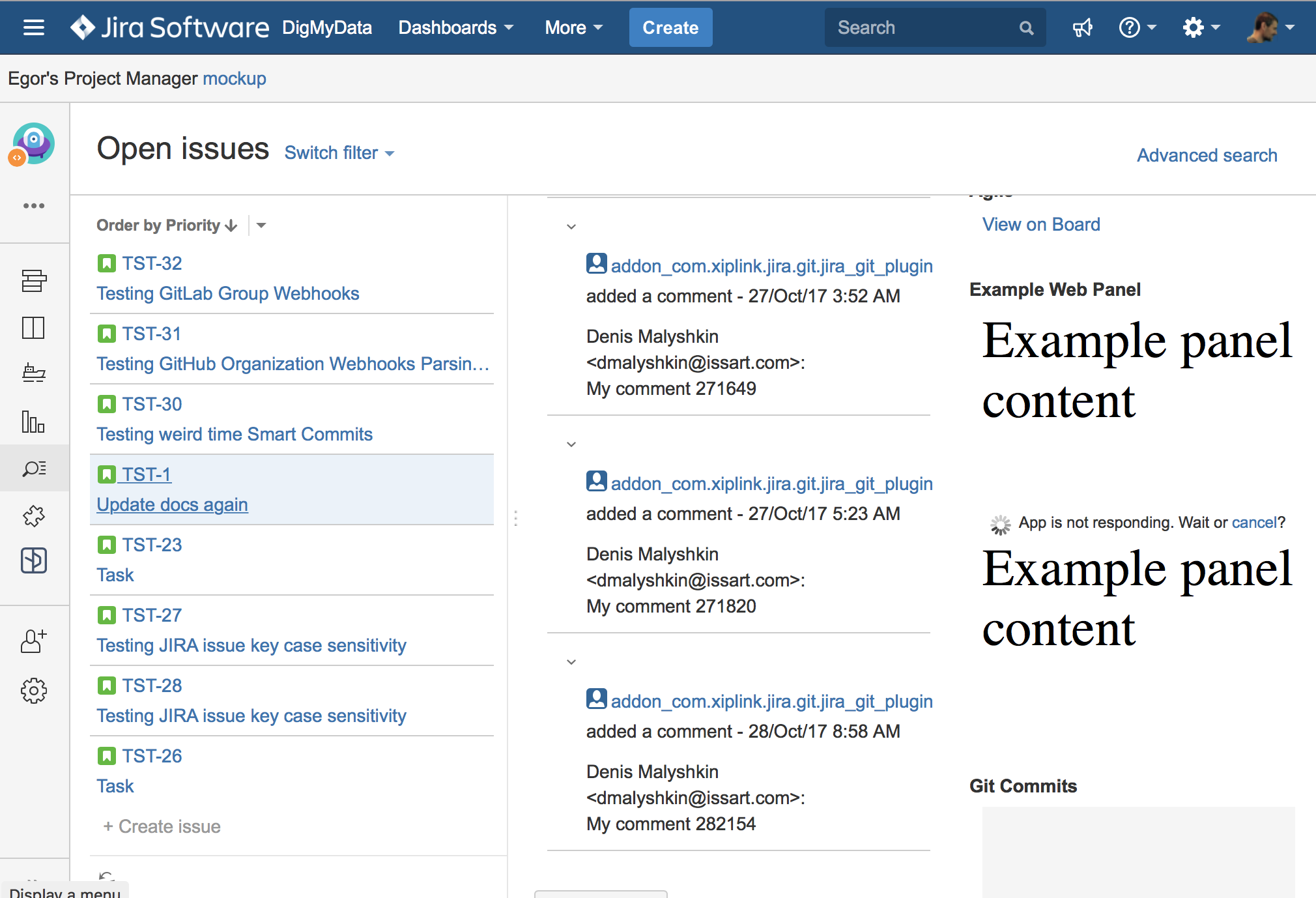

We did some more investigation today and I want to put the results here for others to see.
Here’s some notes from my lead UI dev:
  • When an IFrame is loaded it wants to know where it’s loaded. That’s why it calls this Atlassian API: AP.getLocation.
  • Jira accidentally inserts two our IFrames but their JS connects only to one of them. That’s why it cannot detect that other IFrame is loaded and shows spinner, also it cannot respond to JS API calls like AP.getLocation.
  • This screenshot of Jira layout relates to the problem: Monosnap

We’re now fairly confident that this is a Jira bug.
We can reproduce a double iframe with this simple static example that adds a single panel.
I’ve submitted it to support.
