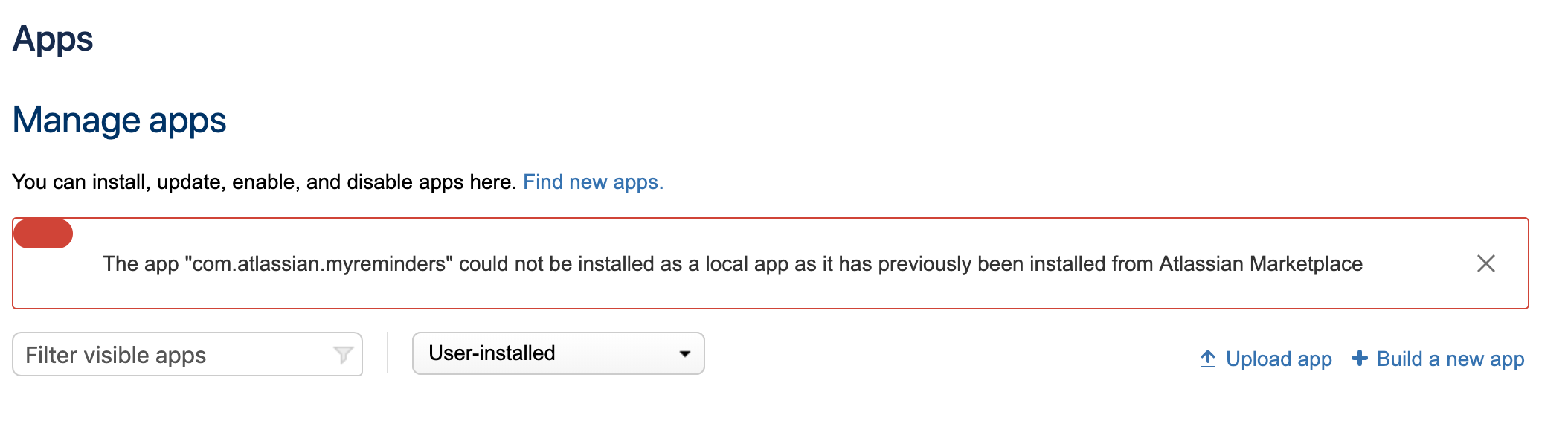

Atlassian products will no longer allow installation of a local app in development mode at “Manage apps“ page, which uses the same key as an installed Atlassian Marketplace app. When this is attempted the install will fail with the following message:
Why this change?

  • Local version of your app won’t work in that case. The error shown in above snapshot will be thrown.

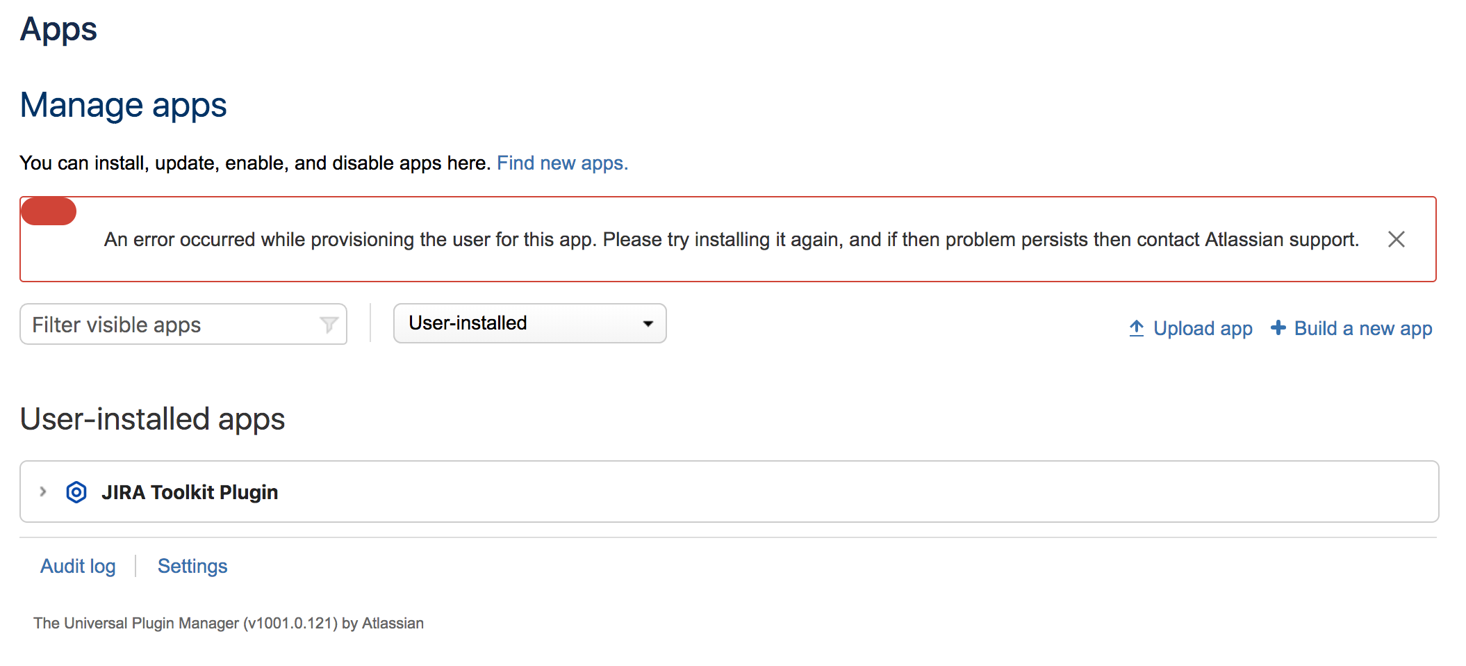

Hi,
So I was looking for a way to reuse a fresh instance of Jira, to test apps installation process. I have created new site, did a backup, then installed our app, everything worked fine. Then I decided to clean the site by importing a backup. I was prompted to choose whether users should be overwritten or merged. I chose “merge”.
Backup was successful, however it is impossible to install the app now.
Is it a known problem? Do you have any other ideas how to clean a Jira instance for testing purposes?
I have also tried a backup with an option to override users, it also doesn’t work. This worries me, because if I can’t do a backup, then our customers probably also have problems with apps after doing a backup
Installing any app from the marketplace also doesn’t work, but I guess I will create support ticket for this, because this thread may be not appropriate

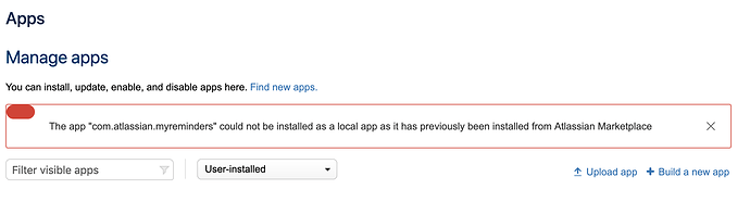

Although we were aware of this change when it was introduced last year, one of our developers has just managed to accidentally brick our company’s primary staging instance.
As part of a database migration (Postgres 10.x -> 12.x), the developer was tasked with testing the uninstall/install flows for our app to ensure that no issues were introduced with the new database version.
The developer uninstalled an app from our staging instance that had been installed from a URL, but instead of reinstalling from a URL they accidentally installed from the Marketplace. After realising their mistake, they immediately uninstalled the Marketplace version and tried to reinstall from a URL…and then hit this issue.
Is there really no way to reverse this innocent mistake? Do we really have to burn our entire staging instance to the ground now (that we’ve been using for many years) and replace it with a fresh instance?
It seems like such a severe penalty for what is a very easy mistake to make.
