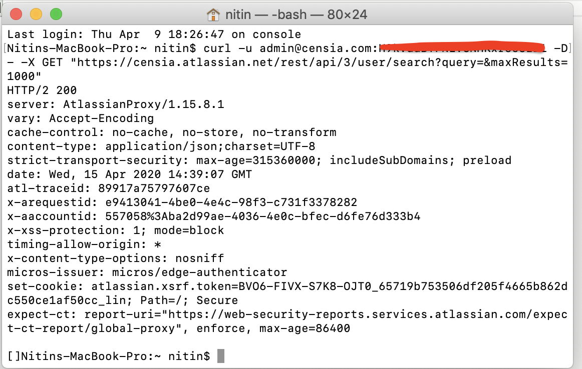

So, reading this post:
I opened GIT Bash and wrote this command:
curl -u "example@mail.com:*******API-Token*******" -D- -X GET "https://myname.atlassian.net/rest/api/3/search?fields=project,summary,reporter,issuetype,created,status&maxResults=1000" > log.txt
I got this on the console:
% Total % Received % Xferd Average Speed Time Time Time Current Dload Upload Total Spent Left Speed 100 52 0 52 0 0 52 0 --:--:-- 0:00:01 --:--:-- 38
It looks like it got 52 bytes of data, but in the log.txt I have this:

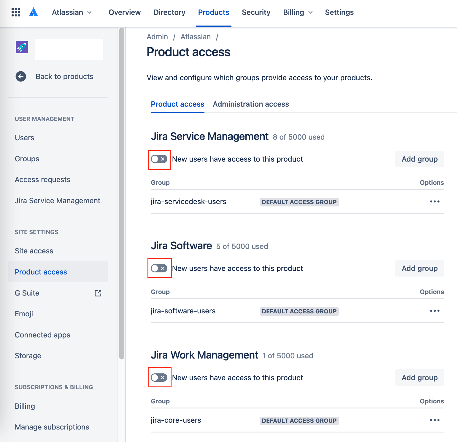

I found that I can convert “customers” into “Atlassian accounts”, and it will solve our problems:
But I’m not the site administrator, and I have to ask if it is a possible solution or not.

Finally, I was able to connect with the ServiceDesk API, making an Atlassian Account to the customer withouth permissions, using Basic Auth. I cannot use OAuth2 because the Atlassian authorization page doesn’t allow him to log in, so it’s a quite good workaround until OAuth2 is implemented on Jira API.
