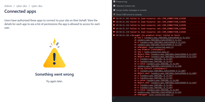

Hi @XavierCaron, a member of my team has this problem again today, but it is not possible to access the Connected Apps page. This is what shows on the UI and in the Console:
Hi @nhac.tat.nguyen
The issue related to the Connected Apps page not working is currently being looked at (there is a related incident on our side).
As for the issue related to the token not coming through, I believe that the existing tokens have expired and therefore a new consent might be required… I am investigating this a bit further.
