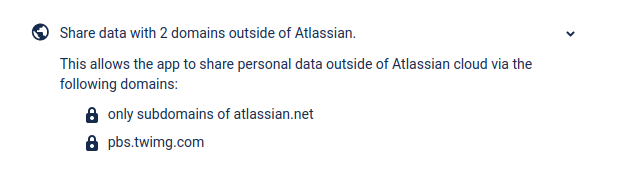

UPD: out of interest, did you try using *.atlassian.net in your permissions.external.images? This should work for all installations if I’m not mistaken.
I can confirm that using ‘*.atlassian.net’ allows all instances as they are subdomains, however this is not the problem so I think I need to step back a bit and re-state the current problem in simpler terms:

  • The above avatar will only render when both '*.atlassian.net' AND 'https://i0.wp.com/' are added in the manifest. This is just for one avatar, and as shown with the above examples, each one would need yet another img-scp added to the manifest (what if 1000 users have different paths, you can’t expect us to add all 1000 domains into the manifest - and if so, how do we know the domains until a User provides feedback their avatar is not being displayed?)

  external:
    images:
      - '*.atlassian.net'
      - '*.wp.com'
  • For default avatar icons, both of the above img-scp permissions are required. This will allow the default icons to be rendered when used with the instance’s baseUrl

In this future world with custom domains, how are we mean’t to handle allowing images from the host product? The URL could be from any domain, iiuc.
Also, allowing *.atlassian.net exposes one customer to items from any other customer’s instance, which is certainly better than allowing images from anywhere, but not ideal given a hacker can create a Jira instance for free.
Ideally there would be a special value we could use in the Forge manifest that stood in for the host URL. If a user views our forge app from Jira on a custom domain, then the CSP value includes that domain. I’m kinda surprised that this doesn’t already exist. Is there anything like that?
