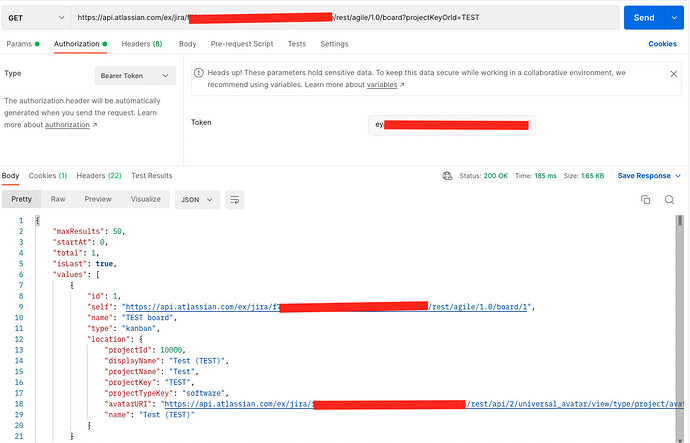

Hi @DavidBroadhurst,
Jumping into the party :slight_smile: Yes, I can confirm that I was able to successfully call a Jira Software REST API using a bearer token on Postman (see the image below).
If you are getting a response of HTTP 401, one possible reason is an incorrect request URL. Using basic auth, you use https://myinstance.atlassian.net/{api} however, using OAuth 2.0 the URL should be in this format https://api.atlassian.com/ex/jira/{cloudid}/{api} (see reference doc for more info).
As for the scopes, here’s the list that I’ve used in this test run (there are probably some unnecessary scopes here as I am using this token for multiple tests)
              "read:issue:jira-software",
              "read:issue-details:jira",
              "read:user:jira",
              "read:application-role:jira",
              "read:avatar:jira",
              "read:group:jira",
              "read:board-scope:jira-software"
I hope this helps.
Ian
