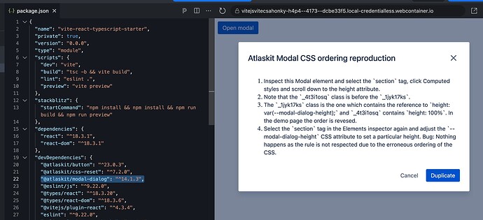

Hi. I am using Vite and I have a very specific CSS ordering issue potentially as a result of this change.
When I update to Modal v14 (which is the first to use Compiled), the height of modals is set to 100% instead of auto. The class referring to --modal-dialog-height is overridden by a class specifying height: 100%. I have looked in my compiled CSS and can confirm the 100% height class is specified after the --modal-dialog-height one, overriding it.
The following screenshots are from Chrome’s computed CSS inspector comparing the Atlaskit Modal examples page and my use of Modal.
Screenshot from atlaskit.design Modal dialog examples page:
Screenshot from my build (is actually replicated during dev mode too)
Seeing as all of the atlaskit files are put into one file, it is simply the order in which they are appended to the compiled file which is causing the issue.
I have tried the vite-plugin-compiled-react vite plugin without success. Are there plans to officially support Vite to guarantee CSS ordering? It’s a pretty popular build tool.

Hi @DanielDelCore, I created a repro here: https://stackblitz.com/edit/vitejs-vite-csahonky?file=src%2FApp.tsx
Edit: Note that this is using the vite-plugin-compiled-react plugin which does not change the outcome.
Ah this particular issue is actually another problem with modal dialog, the css specificity for one of the media queries has changed under certain conditions. We have a PR up to fix that now I’ll let you know when it lands so we can try again :folded_hands: cc @edave
Awesome! Thanks @DanielDelCore!
No worries! OK looks like that patch has been published, would you be able to bump modal-dialog to 14.1.3 and let me know if that resolves your issue?
Appears to be resolved in your reproduction :slight_smile:
Thanks for your help with that issue, that @DanielDelCore. I can confirm it works! :tada:
Great news! Apologies for the inconvenience!
