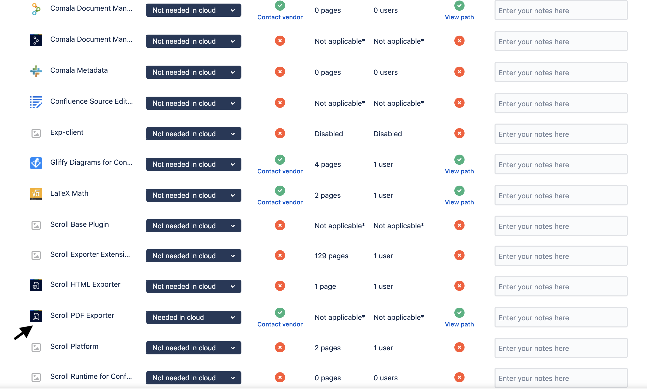

Hi @anon65479381 and @thomasr, from EAP, the completion of App Assessment is necessary for those migrations that have Apps involved.
Therefore, you need to make sure that every installed App should have a deterministic state either - ‘Needed in cloud’ or ‘Not needed in Cloud’ or ‘Use Alternative’. In App Assessment, please make sure that it is true for every app and then go through the flow.

Hi @jrichards
Thanks for your reply,
I also restarted the Confluence Server but it didn’t help.
The page Choose what to migrate in the previous version was showing the apps being migrated.
I attach screenshots of those pages.
