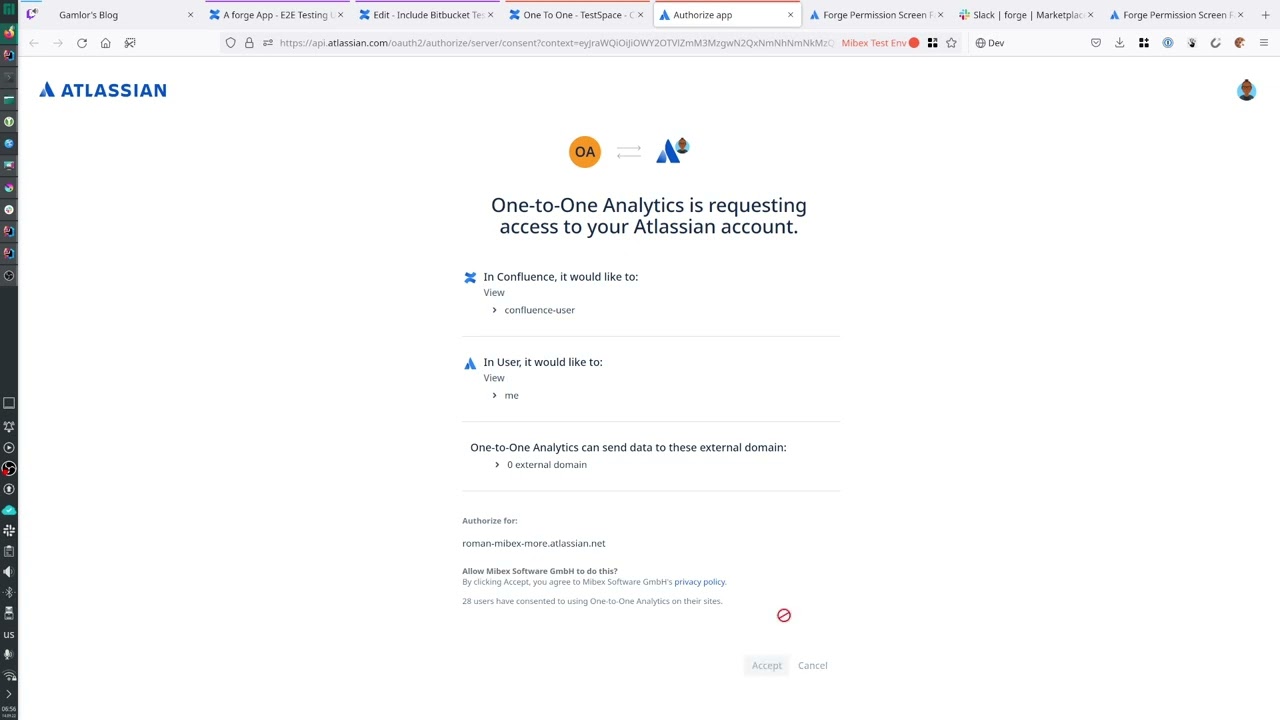

I tried today one of our Forge apps, on two different logins.
And the ‘Allow Access’ endless-loop of death is still a thing:
The allow Access is already a horrible user experience. But having it not work is catastrophic.

@ChrisGraham I’m still encountering this issue. I’ve tried uninstalling and reinstalling the add-on on that instance and clearing the cache. I click allow access on both screens but when I return to the app it loads both the allow access prompt and the app. The app doesn’t load properly as all APIs appear to return 403.

So, the issue doesn’t seem to be fixed for me, on Confluence Macros. Is there a window.BUILD_KEY or some equivalent on Confluence Cloud to check if I am on a release where it should be fixed?
I’ve attached a video on how it acts for me: https://www.gamlor.info/files/allow-access-loop-of-death.webm
Hi @RomanStoffel, thanks for the feedback and the video!
It looks like Confluence Cloud is still using an older version of our internal Forge package from before this fix was added. I’m only familiar with the Jira side so I have asked the relevant Confluence team if there are plans to bump to the newer version and will update here when I have more information.
